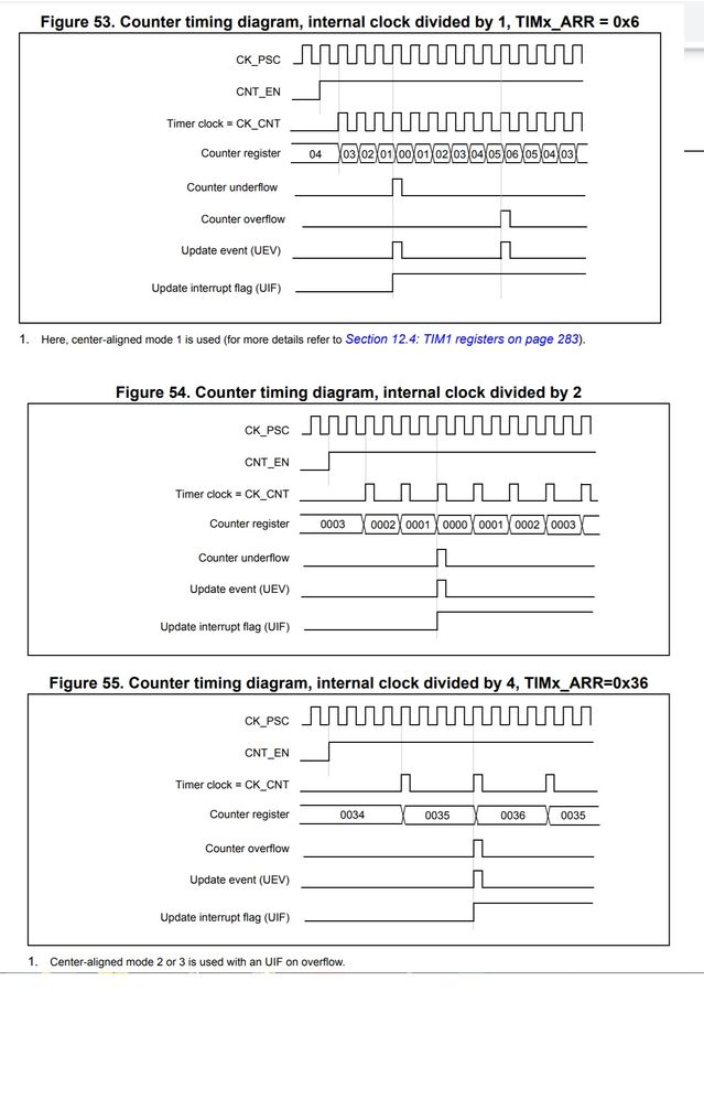

are you sure about it? because it look like from papers, it depends on CMS...the interrrupt is changing with Center aligned modes, it can be set as onderflow,or overflow or both...

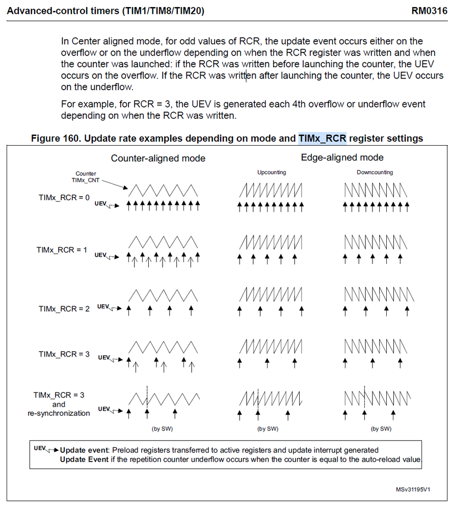

It looks like TIMx->RCR can be used to trigger on every other update, but is only available on some counters. TIM2 is not one of them.
