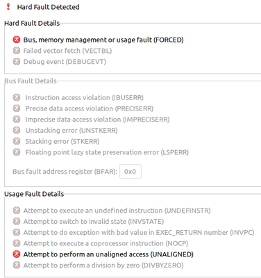

However, if I compile with Optimization Debug(-Og), the application ends up in the Hard_Fault Handler.
The fault analyzer is showing Bus, memory management or usage fault (FORCED)
with Usage Fault Details of Attempt to perform an unaligned access (UNALIGNED).

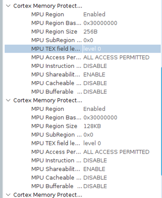

I was backwards on my thinking regarding strongly ordered and TEX level. And agreed, I had the regions out of order.
Set as this solves the problem:

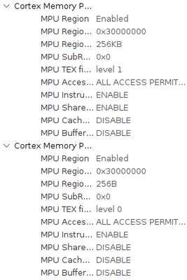

The MPU region where the netx is using memory is RAM_D2 (start 0x30000000) after the .Rx and .Tx. descriptors. I changed the the two sections there to TEX=0 from TEX=1. This makes no difference in how the webserver behaves but the FTP server still ends in HardFault_Handler() at the same point with the same faults. The setting in Cube MX are:

So what is the faulting instruction and the data address shown in the fault analyzer: in descriptors or buffers?
The 2nd MPU area, 256KB, is invalid, because the base address is not aligned on the size. No idea why Cube allows this.

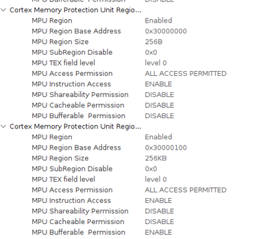

I set up the MPU like this:
which should align ok with my linker directives:

The Fault Analyzer looks like this:
‎2024-04-21 12:37 PM - edited ‎2024-04-21 12:42 PM
So 0x30000c4d is in your 2nd MPU region, with attributes "strongly ordered" (TEX=000 C=0 B=0).
The memcpy function does not expect this (it was designed for normal memory), it probably tries to move data in 32-bit units and crashes on unaligned address.
Btw, the 1st MPU region (256B) has no effect because the 2nd region overlaps it. The MPU is too hard to use in ARMv7. In ARMv8 it is improved and the attributes are more palatable.
‎2024-04-21 8:00 PM
