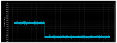

Here's an example of my main() using on a NUCLEO-L452RE (nothing connected) just pins configured. I'm using the button on the Nucleo configured as an interrupt to be able to wake the system for my example. Also is the current measurement which averages ~625uA in stop 2.

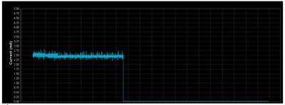

 Now if I modify the code to disable the peripherals before stop mode 2, the current is much better at ~2.6uA. I re-enable them after wakeup.

The peripherals I'm disabling should not be available in stop mode 2 so disabling them should be automatic? Or what is the correct procedure? Wonder why they draw so much current when not even available.
