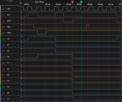

I don't understand it either. From what I see, the data is sampled when (or until) NOE goes high. Interestingly this is not the same moment as when NEx goes high, like the figure in the manual suggests. NEx goes high one clock cycle later.
In the following example you can see a change of the data at the red cursor. this is the data that gets sampled (0xFF). NEx goes high one clock later so it should read 0x00 at this moment, but it does not.
(clkf is 12 MHz HSE input clock and also the FMC clock. on the other end is a FPGA)
