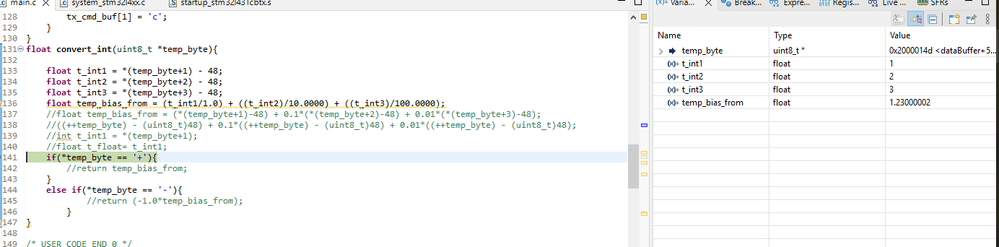

Dear all,
I am having some issues with precision of floating point calculations with STM32L431CBT6.
As one can see that when I do floating point calculation I am getting 1.23000002 instead of 1.23.
Can anyone suggest more efficient and accurate way to do this kind of calculation. I need very precise value for my application.
Thanks and kind regards,
Dibyendu

I think, convert_int() can be replace by atof(), with maybe byte[4] set to 0. Otherwise flot number have some small inaccuracy.
Danish1
Lead III
The C language has two types of floating-point number - float and double.
float uses 32-bits to represent a number and gives between 6 and 9 digits of precision.
double uses 64 bits and gives twice that.
So just use the word "double" where previously you used "float".

It is in the nature of Floating Point that you will get such errors
https://docs.oracle.com/cd/E19957-01/806-3568/ncg_goldberg.html
Have you considered working in (scaled) integers ... ?

@DKhan.1 but note that the Cortex-M4's floating-point hardware is only 'float' - so 'double' will be done in software...
1.23000002 is a more precise number than 1.23.
Or do you mean you want a number with no more than 2 decimal places?
