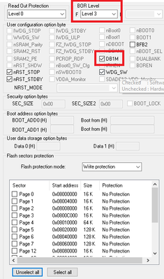

I am experiencing a similar situation. Did you figure out what might be causing the problem? I did several tests but couldn't find it. I did an ESD test, then ST-Link SWD corrupted, and BOR Level and DB1M values changed on the controller.
