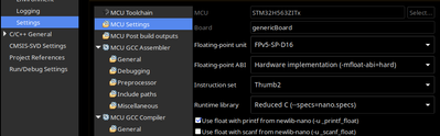

You are using...CubeIDE ? ( no info given)
in menu -> project -> properties :
-> -mfpu=fpv5-sp-d16 -mfloat-abi=hard

Perfect thank you. I'm having trouble installing CubeIDE on my PC, but thought I would easily find the information somewhere. I Accept the Solution but I would like to know if this is documented somewhere.
