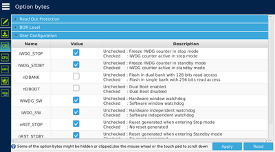

MCU: STM32F765ZIT.
FLASH size: 2MB.
I have a problem when running my firmware, with FreeRTOS, with or without a debugger.
My code is crashing in the HAL_Init() function when nDBoot¹ is enabled.
When I initialize the code through the debugger, it enters the HAL_Init()² function and crashes when trying to execute the HAL_MspInit() line, but I suspect that the problem actually occurs in the previous function, HAL_InitTick(TICK_INT_PRIORITY)³.
My function uses Timer 7 as the default for the FreeRTOS tick, as recommended by ST itself when using this middleware.
For testing purposes, I modified the HAL_InitTick function so that it would be similar to the HAL default⁴.
Even after this modification, it did not work.
So, after further testing, I decided to disable nDBoot (setting it as checked by STM32CubeProgrammer) and then the code worked perfectly. nDBank remained unchecked.
The problem is that now, without nDBoot enabled, I can no longer use dual boot mode and switch banks.
If anyone can help me, I will be very grateful
¹ I needed to enable nDBoot and nDBank (set as unchecked by STM32CubeProgrammer) because I am working with Dual Boot, and I have a firmware recorded in each bank.

lealmicael
Guys, I'm just here to tell you how I solved my problem.
Basically, it was a problem related to VTOR (Vector Table Offset). When initializing the code, the value contained in VTOR was always 0x100000 (system memory bootloader address).
What I hadn't realized was that my SystemInit function (system_stm32f7xx.c file) wasn't making the following assignment:
SCB->VTOR = VECT_TAB_BASE_ADDRESS | VECT_TAB_OFFSET;
This was happening because USER_VECT_TAB_ADDRESS was not defined at the beginning of the file.
So, I just uncommented the line #define USER_VECT_TAB_ADDRESS and everything worked perfectly!
Here's the log to help anyone who needs it.
