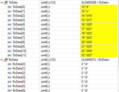

So I have connected the LoopBack. The interrupt works fine. In the Callback function I can see the TxBuffer changing but the RxBuffer doesn't update. When I meassure with osciloscope I get nothing on the Rx and Tx fdcan pins. I dont have the transciever connected to the Tx and Rx, should I have done it ?

No need for a transceiver in Loop Back mode.
Did you select External Loop Back mode? this is the mode where you can see the frames on Tx pin.

Yes, I chose the external one
