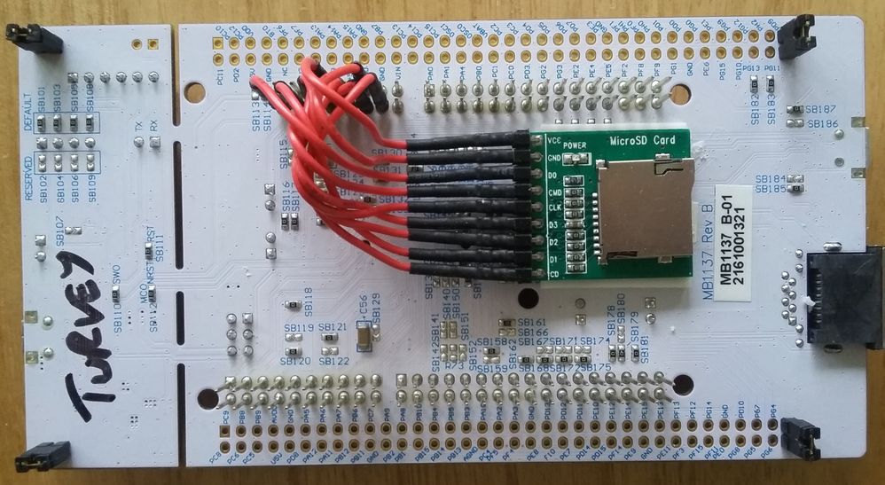

Would you be able to share your test-project for the Nucleo here? I'm also struggling with the H7 and SD-card, and am starting to suspect I'm somehow doing something completely stupid and a working demo-project would be helpful!

Clive, may I ask what value you are using for the SD clock divider (i.e. at what frequency are you running the card)? I noticed an interesting behavior in my code: when I use a very low divider value (0 to 5), and hence a high frequency, it completely fails to initialize the card (HAL_SD_Init() returns an error). I suspected that this might be due to my messy wiring (also I did not yet desolder SB116 and SB117) and therefore increased the clock divider. Starting at 6 (corresponding to just 6 MHz bus frequency) the call to HAL_SD_Init() succeeds but then the FatFS calls f_mkfs() returns FR_DISK_ERR ('A hard error occurred in the low level disk I/O layer').
Do you still have your working Nucleo+SD-Card combo assembled? I know this is asking for a lot but could you try to run my test application on your board and see whether it works for you? I attached the project (GCC Makefile project) to this post, it also includes a compiled elf-file in the build folder. The app prints debug information over the ST-Link Uart with 115200 baud. Note also that it tries to format your SD-Card so please be careful!

The STM32 get more complex and confusing clock routing as time progress. The SDMMC clocks at 200 MHz. Down stream code limits ClockDiv based on card type. I would not call MKFS, and in fact during initial bring up do read-only operation. In ff_conf.h I disable MKFS and enable EXFAT and LFN support.
I have two NUCLEO-H743ZI boards wired up, and also an STM32H743I-EVAL, but the latter has the bus transceiver and a bit more complicated interface for higher speed cards. Don't have the Nucleo boards with me, and not looking to do a destructive test on my cards. I will do a static review of what you have provided.

Ah that's interesting! Seems then that the corresponding description in CubeMX is wrong:
SDMMCCLK clock divide factor
ClockDiv must be between 0 and 255.
Parameter Description:
SDMMC_CK = SDMMCCLK / [CLKDIV + 2]. The output clock frequency can vary between 187 KHz and 24 MHz. It is advised to keep the default ClockDiv value (0) to have a maximum SDMMC_CK frequency of 24 MHz.
Anyway, the good news is that I got it working at least in 1bit mode (I'm kind of embarrassed that I didn't try this earlier...) so I'm strongly suspecting some signal integrity issues here due to my long and messy wiring  Will try a different SD socket breakout and shorter wires soon and report back here.
