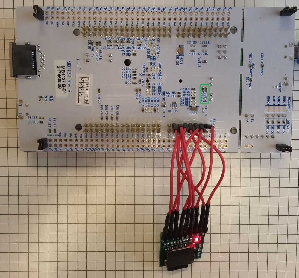

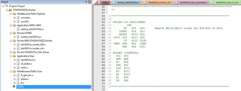

My approach has been to port the HAL code from the STM32H743xI-EVAL board to the NUCLEO-H743ZI, creating a stm32h7xx_nucleo_sd.c
Posted on February 21, 2018 at 17:53
So far, the pinout i'm using is OK.
I can say that because my SD card is answering me.
The command BSP_SD_IsDetected() provided by the cube is working
it returns me 1 if there is an SD card and 0 if there is none.
Second point that can confirm what i'm saying is that f_mount(&SDFatFS, (TCHAR const*)SDPath, 0) answer me 'FR_OK'
I dig up a few an come to f_open(&SDFile, 'STM32.TXT', FA_CREATE_ALWAYS | FA_WRITE). but this one is not working. Indeed, i code the answer
FR_NOT_ENABLED
Note : &SDFile is declared like so : 'FIL SDFile'
And ... well  i have no clue at the moment why it's not working ...

JC Lebreton
Posted on February 22, 2018 at 09:33
two things in one!
First of all, it works like a charm! (some issue about permissions but that's not a big of a deal now!)
I remove as mentionned before the '0ohm' resistor on pin SB116 and SB117
and ... well it makes things work!
if also changed a bit two functions :
  • FATFS_LinkDriver(&SD_Driver,(TCHAR const*)SDPath)
    FATFS_LinkDriver(&SD_Driver,'')
  • f_mount(&SDFatFS, (TCHAR const*)SDPath, 0)
    ->f_mount(&SDFatFS, '', 0)
I keep things simple here to start understanding how things work!
thank you Clive for the help you provide me!
And for the others who would like to make the same stuff work, here is an easly understandable code!
