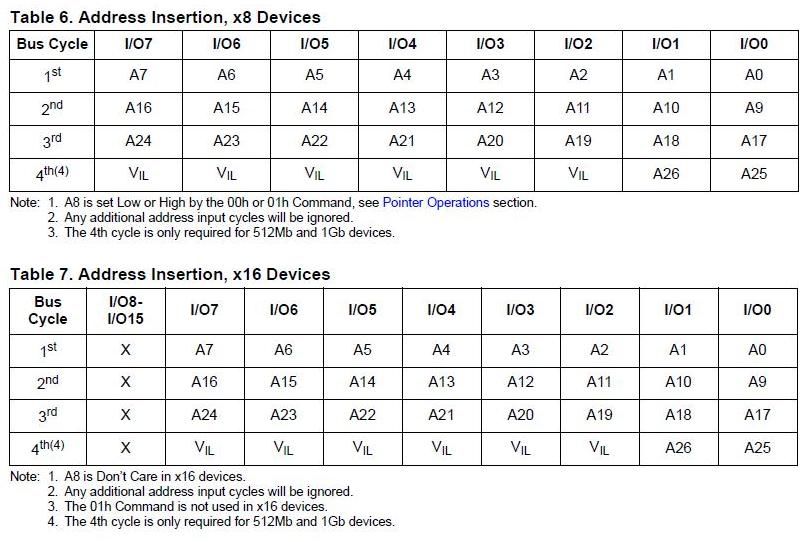

what is the NAND Flash model or family ? Row and line addressing in Nand Flash are not always compatible between the ST Nand and the Atmel Nand.- Mark as New

> you must check that the address insertion in the read_block/write_block functions of your Nand Flash software driver comply with the address insertion format in the table above.
The same read_block/write_block functions are used by Mass_Storage Mode, when it is used with Computer. And the Mass_Storage mode can write to the NAND.- Mark as New
