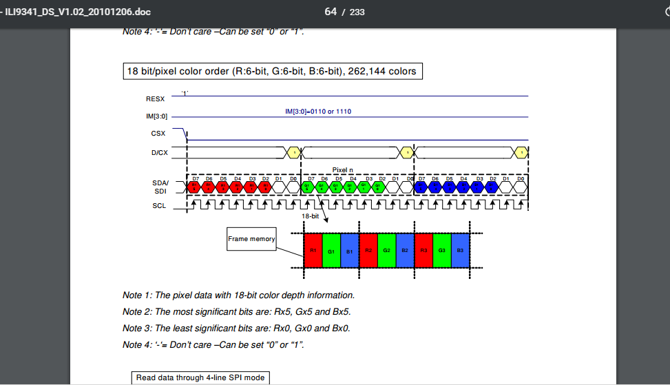

Just spotted an issue, after click on the Add comment. One extra 'spi_dma_cmd(LCD_GRAM);' in the above. caused the issue. It appears working with the flood_fill. But my first question on the RGB:666 still exists.
Posted on March 12, 2017 at 16:12
I would like to avoid the extra hardware, if possible. But anyhow, it is good to know such a solution exists. I am additionally looking at the 8 bit SPI transfers, as you mentioned previously in the thread. Wondering whether that would work with the LCD configured in RGB666 mode. If that works, it would be even better, to switch to 18bit mode from the 16bit mode.
Posted on March 12, 2017 at 17:27
The answer is in the 2010 spec...
For transfer 24 bit to get an 18 bits pixel done, compared to 16 bit per pixel. No LSB/MSB issue for a 3x8 bit quantity.
