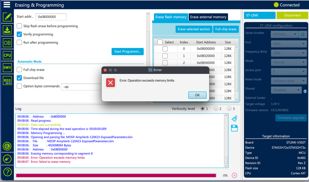

Hi, I am working on a project with the STM32H730. In order to make full use of the onboard memory I have the project set up to load some objects into DTCMRAM. This works, however the binary size is huge, like 403 MB, and subsequently is crashing cube programmer:
It seems like something is going wrong here and a huge amount of unnecessary information is getting stored in the binary file.
Can you recommend a way to fix this while still using DTCMRAM for data?

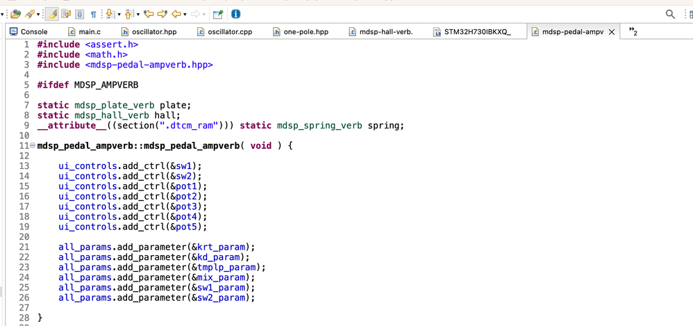

Here is the DTCMRAM section of my linker file, and how I am allocating objects to DTCMRAM:

You need to split the .BIN files into sections. Or use .HEX or .ELF which has the meta-data for discontinuous / sparse data regions.
Secondarily you need to manage RAM initialization in startup.s, or make the sections NOLOAD
See how startup.s unpacks and clears the RAM via statics it stores in the ROM/FLASH section.

NOLOAD would mean there is no data in the section, there would be NOBITS in the .ELF file, and you wouldn't be trying to "program" a section of RAM in STM32 Cube Programmer. Content disappears after power cycle.
https://community.st.com/t5/other-tools-mcus/defining-noload-section-in-ld-script-for-gcc/td-p/334763
https://docs.oracle.com/cd/E19120-01/open.solaris/819-0690/gjpww/index.html
https://stevens.netmeister.org/631/elf.html
There's a lot of documentation on the link, linker scripts, and the .ELF format on-line
The .BIN and .HEX are generated from the .ELF
Keil's FROMELF tools by default splits sparse sections into individual files, so there aren't multiple MB or GB voids in the files.
Okay, maybe to hone in on what I need specifically.
I am only using TCMRAM because I ran out of regular RAM for the project. This is an audio DSP process that involves several large delay lines and some of them need to live in TCMRAM to fit in internal memory. There is no TCM aspect I need for this, it's just to have all the delay lines fit in onboard memory.
I would like the TCMRAM to function exactly like regular RAM in every way (loaded how RAM gets loaded, not bloating .bin filesize).
How do I do that?
Don't involve any TCM in the linking/imaging of your app & manage the TCM directly via your code.
>>How do I do that?
If you need the memory initialized with content you need to stage it in FLASH and copy it out
} >DTCMRAM AT> FLASH
If it does not then
.dtcm_ram : (NOLOAD) {
Remember it processes the Linker Script in a linear fashion so the order it encounters sections, and the way you define symbols matters. I've provided a general outline of how the script flows.
In startup.s you've got to use the symbols to initialize the space by copying the content from the staging area in FLASH. See how (_edata - sdata) define the size of the staged data, _sdata where it goes, _sidata where it comes from for the ">RAM AT> FLASH" .data section
