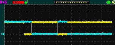

I'm using the STM32F091 microcontroller on a custom made PCB, i'm reading two switch buttons, both have the following configuration (image below), the SENS_P signal go directly to PA10 of the microcontroller which is configured with EXTI triggered by a rising edge. (This part of the schematic was copied from a Nucleo board schematic).
I'm having an issue when i push the switch button, sometimes the interrupt is being also triggered on the falling edge of the signal, to debug it I'm toggling a test point like so:

And the following screenshoot of the oscilloscope shows the issue, where the yellow signal is SENS_P and the blue signal is TP, you can see how on the first change on SENS_P the interrupt is correctly triggered on the rising edge, and in the second change the interrupt is being triggered on both falling and rising edge of SENS_P.
Do you think i'm having a rising edge on the yellow signal, so fast the oscilloscope isn't able to detect it? or does it seems more like a hardware issue?
Yes. Buttons bounce, and EXTI is not filtered by any means. The hardware filter is nice to have, but not a panacea.
