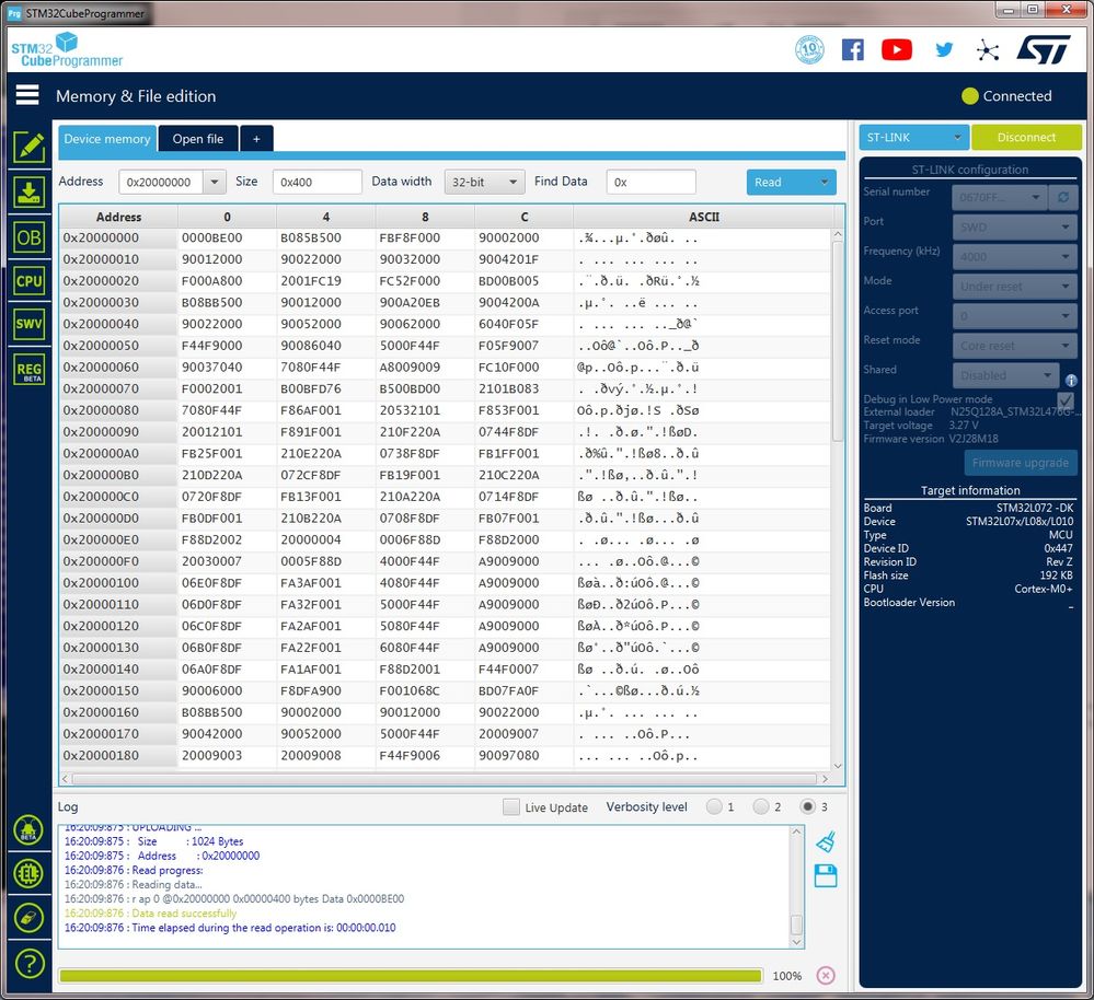

Used as the return address in the link register (LR) , when calling the exported sub-functions, ie Init(), Write(), Verify(), etc

16:10:16:007 : UPLOADING ...
16:10:16:026 :   Size          : 1024 Bytes
16:10:16:026 :   Address       : 0x90000000
16:10:16:026 : Read progress:
16:10:16:027 : Reading data...
16:10:16:027 : halt ap 0
16:10:16:027 : w ap 0 reg 15 PC   (0x20000000)
16:10:16:027 : w ap 0 reg 17 MSP  (0x20000500)
16:10:16:027 : w ap 0 reg 16 xPSR (0x01000000)
16:10:16:027 : w ap 0 @0x20001DC0 0x00000200 bytes Data 0x00000000
16:10:16:031 : w ap 0 @0x20000000 0x00000004 bytes Data 0x0000BE00 <- Writes BKPT
16:10:16:087 : w ap 0 @0x20000004 0x00001998 bytes Data 0xB085B500 <- Writes Loader Image
16:10:16:088 : Loader read...

You can also get the tools to read the RAM. Note on the H7 series 0x24000004 is used..
