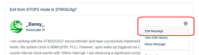

Please see How to insert source code.
The indentation is now all lost - so you'll need to copy it again from the original.
You can edit your post:
