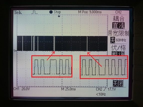

Now the problem has been almost almost solved. There used to be near 900ms of vacant of pulses, and Now the pulses are almost continuous. The stepper motor runs well with this waveform.
Following Clive's advices I adapted my code, then it WORKED!
but the waveform is near ideality
. There are glitches in the waveform and Here is my Explanation:
For normal cases, the CC1IF bit is set and then the TIM1_CC_Interrupt Pending bit(NVIC_SETPEND0.27) is also set by hardware, then
 the hardware could toggle the pin of TIM1_CH1 ,generating the desired waveform.
BUT, there is another situation:
suppose the ISR entered and it was triggered by CC2IF. in the ISR, first I would read TIM1_SR to memory: TIM1_SR_mask = TIM1->SR;
But JUST after I read TIM1_SR, the CC1IF occurs. Because CC2IF bit is high now, the Interrupt Pending bit(NVIC_SETPEND0.27)
will not be set
, so the hardware won't toggle TIM1_CH1 output pin. So we observed a missing of pulse, i.e. two successive low/high voltage levels.
Are my guesses right?
By the way, I think this is not a good design of the chip that if the CC2IF is 1 and configured as a TIM1_CC_IRQ source, then a new arrival of CC1IF(also enabled as a interrupt source) would not pend the Interrupt Pending bit again.
This compels me to add a judgement whether I missed a CC1IF or CC2IF and then manually pend the Interrupt Pending bit.
And this is why I use ''if'' statements and
NVIC_SetPendingIRQ(TIM1_CC_IRQn) before I quit the ISR. This is also a cost of the valuable time of the ISR.
Below is the waveform quite near to ideality. Glitches could still be observed.

My occasion is: using CCR1 and CCR2 in output compare mode(toggle). Every time in their ISR I add a Delte_CCR1(562) and Delta_CCR2(18000) to generate two different frequencies. I configure BOTH CC1IF and CC2IF as the interrupt source. To make the problem clear, I clear CC2IF as soon as TIM1_CC_ISR enters. Then I Only check CC1IF, if it is 1,I add Delte_CCR1(562) to CCR1. Even if while I am reading CC1IF, the hardware set it to 1, that does not matter because the Interrupt Pending bit(NVIC_SETPEND.27) will be set and next time the TIM1_CC_ISR would handle it.
BUT, the PROBLEM came HERE:
In simulation, there is nothing wrong, the running is exactly as what I expected and then a perfect wave is generated.
But, when I connect to the hardware(with JLink), the wave is corrupted and there would be a 900ms vacant of pulses (which is pure high voltage level) every several seconds...Arrrrgggghhhh....
I add several lines and a breakpoint to test this situation would be happening:
if there are 4 contiuous TIM1_CC_ISR with the CCR1 value unchange, it shows that the problem has happened.

Don't use bit-banding on TIMx->SR, and be very careful using it on any peripheral register. They do not operate like memory cells, so writes are generally dangerous, have side-effects, or simply aren't particularly efficient.
Specific things to watch are registers which point internally to different structures (USART->DR), registers which when read/written impact status stored in other registers (SPI->DR - TXE, RXNE), registers designed to provide atomic clearing of bits which can be modified by the CPU/Peripheral independently (TIM->SR).
When programming peripheral registers it is a lot more efficient to read the whole register, mask the bits being used with an AND, and then OR back all the settings, an then writing it back. Modifying one bit at a time is about the most inefficient thing you can do on a LOAD/STORE architecture.
