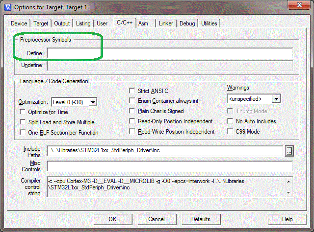

When i run this code I keep getting errors like these;
linking...
.\ro6.axf: Error: L6218E: Undefined symbol GPIO_Init (referred from main.o).
.\ro6.axf: Error: L6218E: Undefined symbol GPIO_PinAFConfig (referred from main.o).
.\ro6.axf: Error: L6218E: Undefined symbol RCC_AHBPeriphClockCmd (referred from main.o).
.\ro6.axf: Error: L6218E: Undefined symbol RCC_APB1PeriphClockCmd (referred from main.o).
I'm new enough to using the board so could be a small thing. Any ideas what I'm doing wrong?

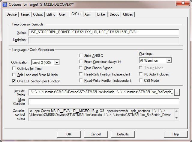

Posted on March 18, 2015 at 20:13
I already have those files in my project folder and have the pathway to the folder containing all the files chosen.
ZIP/RAR the project tree, I'll rack it up here and see. The error messages suggest it's not pulling that stuff in.
The other meta-data in the project are the preprocessor defines ''USE_STDPERIPH_DRIVER, STM32L1XX_HD, USE_STM32L152D_EVAL''

Posted on March 20, 2015 at 11:23
Thats my project that I have been trying to get working.

Posted on March 20, 2015 at 21:31
Ok, that's just the project definition file, not the project. Doesn't look like you have the defines set.
