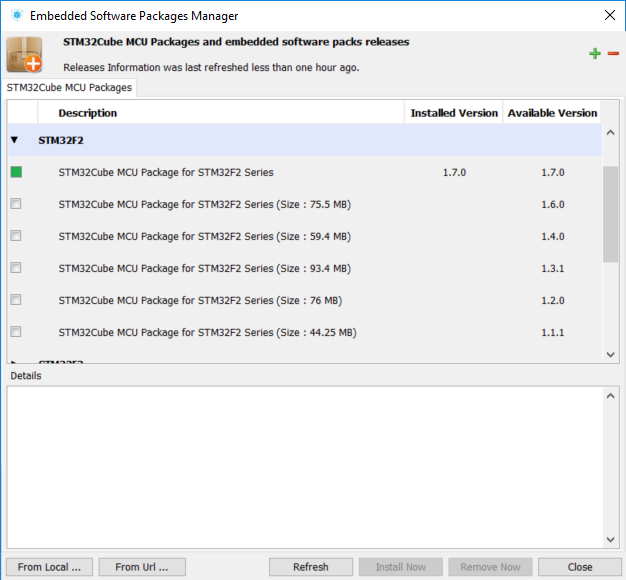

I am looking for 1.1.3.
I see the CubeMX has an option to check off versions, but there is no 1.1.3:
Posted on March 12, 2018 at 17:20
So I cannot help then. Maybe someone have it on a private drive OR someone from ST is willing to share it.

I was thinking the download was the package version, different than the HAL inside? For instance, HAL 1.1.2 was inside 'en.stm32cube_fw_f2_v131'.
However, we believe we have found the issue. There is something causing a UART_DMAError() that we need to track down. It seems that 'those who came before us' commented out the HAL_UART_ErrorCallback() to work around this. Since we did not have the stock 1.1.2 until recently, we did not know they had modified that one line.
So the quest continues in a new direction.
