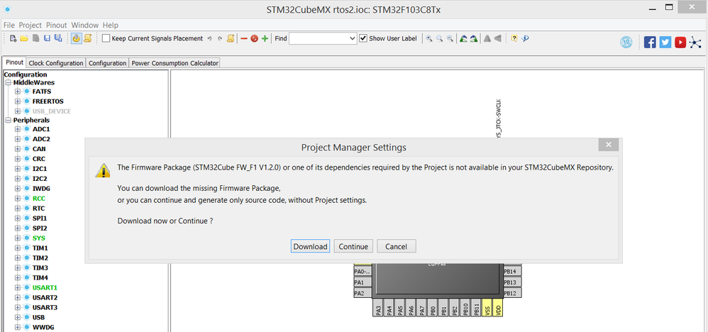

Try this trick:
-generate simple project file using CubeMX
-close the CumeMX
-edit the project_name.ioc file, find something like that(this one is for F103): ProjectManager.FirmwarePackage=STM32Cube FW_F1 V1.2.0
-replace the the number with the one you are looking for
-start the CubeMX
-generate code - the CubeMX will complain about lack of the librarry you are using and will download the library
It worked for me for F103

Or another idea  - try to guess a path. In my case the path was as follow
www.st.com/resource/en/firmware2/stm32cube_fw_f1_v120.zip
Posted on January 12, 2018 at 23:08
In your case you need to guess the exact F2 lib version because the 1.1.2 seems to not exits
Posted on January 12, 2018 at 23:11
I discovered that the pattern for F2 is as follows:
http://www.st.com/resource/en/firmware2/stm32cube_fw_f2_v110.zip
It seems that 1.1.2 does NOT exist
