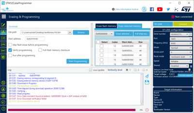

I'm trying to run dual QSPI Flash with my own design STM32H750XBH6. Flashes are 256 mbit MX25L25645. Single mode 32 mb flash read, write and boot succesfully. However, when I switch to dual chip mode, i get a write error (constant 0XFF) on the 2nd chip after 0x93000001 (48 mb) adresses. (adress 0x90000000 to 0x92FFFFFF  working very well. )

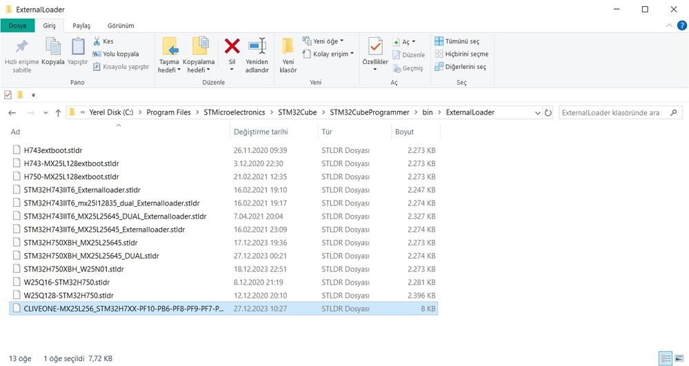

Hi, I download it, its not work. Your .stldr file is only 8kb. My .stldr is 2.274 kb.

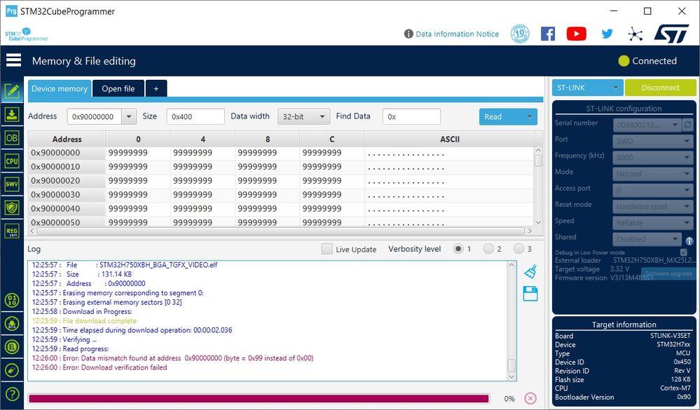

During my tests, 2 of my flashes constantly dropped to 0x99 reading.  My guess is that I accidentally enabled write protection. I don't know how to fix this. The chips that stopped reading/writing were both connected to the bk2 data line. I installed both chips that constantly read 0x99 on a card. this is the situation;
2. full chip erase (mass erase) not working in cube programmer.
Thank you very much again for the problem that I have been struggling with for days.
Yes, more indicative that they are not responding to commands.
If you have application side code to run and query the QSPI devices individually or paired, perhaps try the READID / RDID without the reset operations. Stick in SPI / 1-bit modes.
The STLDR don't have to be massive. Plus I removed a lot of the debug and symbolic sections.
The actual code/data foot-print of yours looks to be around 139KB, still quite massive. The side-effect is that space used by the loader can't be used by the programmer to inter-stage your data to write to the flash, so it does more / smaller transactions on the Write() function.

The chips are actually write protected. I solved the problem by reading a little datasheet and writing a small spi adjustment code.
