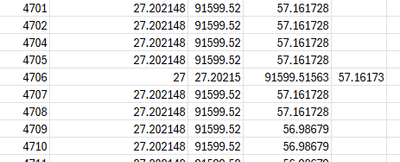

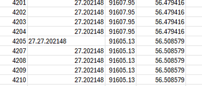

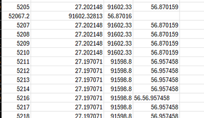

I am working on a data logger project using SDIO with DMA and FreeRTOS. The only sensor currently in use is the BME280, which is working fine. However, I am encountering issues when writing the CSV file, such as glitches, character repetition, and other seemingly random problems.
Here is the relevant code:
/* USER CODE BEGIN Header_StartSDTask */
#define BUFFER_SIZE 4096
#define BUFFER_THRESHOLD BUFFER_SIZE/4*3
#define HEADER "Time;BaroTemperature;BaroPressure;BaroHumidity;PitotTemperature;PitotDiffPressure;Latitude;Longitude;IMUax;IMUay;IMUaz;IMUgx;IMUgy;IMUgz;IMUmx;IMUmy;IMUmz\n"
char buffer[BUFFER_SIZE] = HEADER;
uint8_t sensorsResponse;
uint16_t adress = sizeof(HEADER) - 1;
uint32_t maxAdress;
uint32_t lastTime;
uint16_t count = 0;
uint16_t count2 = 0;

  • The BME280 sensor is functioning properly.
  • The issue arises when writing to the .csv file, with glitches, character repetition, and other random problems.
  • I have monitored the task stack, which is using about 500 words of the 9000 available.
  • I suspected that the problem could be related to the use of snprintf, but I did not find any issues like .. or .xx. in the buffer.
  • I tried increasing the clockdivider to 4, but the problem persists.
  • I believe the issue may be related to FreeRTOS preemption, but I have enabled NewLibReentrant and FS_REENTRANT, and no other task uses the SDIO or FATFS.
