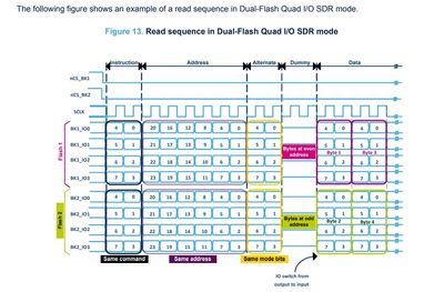

I'm trying to run dual QSPI Flash with my own design STM32H750XBH6. Flashes are 256 mbit MX25L25645. Single mode 32 mb flash read, write and boot succesfully. However, when I switch to dual chip mode, i get a write error (constant 0XFF) on the 2nd chip after 0x93000001 (48 mb) adresses. (adress 0x90000000 to 0x92FFFFFF  working very well. )
Ok, but this isn't how it interleaves

The SR will need to be paired.
ie
test_buffer[0] = (test_buffer[0]) & 0xC3) | 0x40; // SR First Bank
test_buffer[1] = (test_buffer[1]) & 0xC3) | 0x40; // SR Second Bank
I would make sure the BP bits, which are sticky, are also cleared otherwise writes and erases can fail due to protection mechanics. This can be problematic when switching vendors as these bit definitions can be different. I've mostly seen myself locking Micron's by using Macronix code because the 0x40 is a Protection Bit in their context.
I'm also not sure you need to switch parts to use 4-Byte (32-bit) addressing mode, there are commands that explicitly define 3 or 4-byte .
For loaders, I'd keep them as simple as possible at the outset. You don't need to switch into the most exotic modes, performance is usually more to do with how fast the ST-LINK/V2 or V3 can shovel data across the interface.
In dual bank the page write can expand from 256 bytes to 512 bytes, as it interleaves between the two chips.

The polling method would need to span both devices. ie you'd need to read status registers as a pair of bytes.

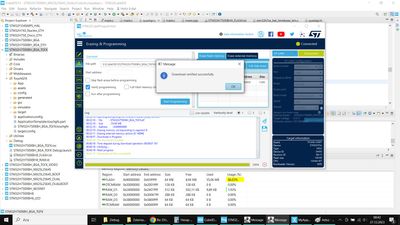

Would probably lean to using the Quad Command's rather than engage QPI mode, so Init() path can be optimized
@Tesla DeLorean thank you for your solutions!! :) now work fine
Yes, stlink V3 is the bottleneck when writing flash. Its takes about 15-20 minutes when 64 mb flash writing.
But, dual qspi MemoryMappedMode better than single flash. I can run to tgfx animated picture on the 1024 x 600 pixel lcd without any flicker or frezing. H7 series mcu most performing one.  If there were no 256 mbyte limit, I would like to try two 1 gbit nor flash (with a little writing patience and more coffee breaks)
