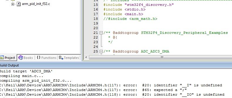

I need to use DSP libraries such as  BasicMathFunctions, but I have a lot of error messages, you might describe the procedure to include these libraries??
error messages like:
.. \ main.c (18): error: ♯ 5: can not open source input file ''ARMCM4.h'': No such file or directory
Target not created

system_armcm4.c and startup_armcm4.s are duplicative of files provided by ST, remove them from the project.

Your file
arm_pid_init_f32.c
pulls in
arm_math.h
In
arm_math.h
, you find this:
#define __CMSIS_GENERIC              /* disable NVIC and Systick functions */
#if defined (ARM_MATH_CM4)
  #include ''core_cm4.h''
#elif defined (ARM_MATH_CM3)
  #include ''core_cm3.h''
#elif defined (ARM_MATH_CM0)
  #include ''core_cm0.h''
#else
#include ''ARMCM4.h''
#warning ''Define either ARM_MATH_CM4 OR ARM_MATH_CM3...By Default building on ARM_MATH_CM4.....''
#endif
So, just add the define ARM_MATH_CM4 to your project settings.
The file
core_cm4.h
is coming with the DSP_Lib, so there shouldn't be a problem.
Posted on October 15, 2012 at 17:22
Do you have the define ARM_MATH_CM4 set for the project?

Your supposed to pull in the library file to your project (the .lib file), not the source for it. I presume you just want to use the functions within the library? If you want to compile the DSP library source you'll want to review the project files.

I just want to use the functions pid ...
how do I define the file ARM_MATH_CM4 in the project?
Posted on October 15, 2012 at 18:38
#define ARM_MATH_CM4
#include <arm_math.h>
or
Add it into the project
Settings -> C/C++ -> Preprocessor Symbols -> Define
