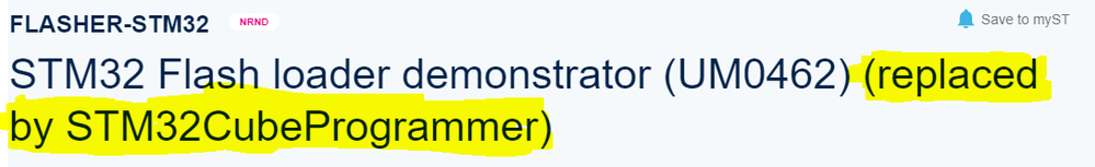

Hello @Lkim.1​ ,
Flash Loader Demonstrator is deprecated and isn't guaranteed to work on newer parts.

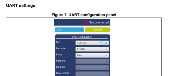

0693W00000BdOdiQAF.pngPlease check section 2.1.4, figure 7 for the steps you need to follow in STM32CubeProgrammer's user manual: https://www.st.com/resource/en/user_manual/um2237-stm32cubeprogrammer-software-description-stmicroelectronics.pdf

Hello~ : ) thanks for your kindness reply
I'be tried what you said. using STM32CubeProgrammer, with UART connect.
but it still doesn't connect well..
it shows error which is "Error: Activating device: KO. Please, verify the boot mode configuration and check the serial port configuration. Reset your device then try again... "
so I think I need to check one by one.
  1. I tried to boot as System memory , is that correct?
  2. I set option bits BOOT_LOCK = 0 , nBOOT1 = 1, nBOOT0 =0 , nSWBOOT0 ( cause I'm using PB8 as output ) , is that correct?
  3. I tried to connect while plug in STlink V3, (without connecting ST-LINK) , is that problem ?
  4. I tried to connect Uart3 pin in mcu, STM32G474 doesn't support Uart3 as bootloader ?
  5. I use Uart3 and baudrate is 14400, so I tried to connect baudrate 14400. is that correct?
I need your help really ,,
I have no Idea what should I do next...
Use SWD/JTAG ?
The UART off the loader is sensitive to all the potential connections sources, see AN2606
ie if you have a GPS/GNSS receiver chattering on one of the other monitored UARTs it will see that first.
You have ONE shot to send the 0x7F data pattern, you'll need to reset and start over if it sees a different pattern.
I use JTAG for option bytes
uart is just serial port . not using JTAG
I don't have any GPS/GNSS receiver...
I thought STM32cube programmer send 0x7F automatically when I click connect button.
I send the 0x7F data using terminal program. but there is no ack return. something's wrong on chip?
