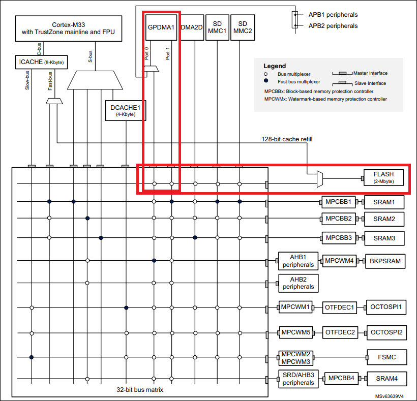

Also in the reference manual in Figure 1. System architecture in the bus matrix there is a link between the internal Flash and the GPDMA, so the GPDMA support writes to internal Flash.
the snapshot below highlight the communication link between the GPDMA and the internal Flash.

@Mohamed Aymen HZAMI​ Thank you for taking the time to respond. Unfortunately, I do not think this provides any new information. I already mentioned the Flash-to-RAM example in my original post; that example doesn't tell me much about DMA transfers in the other direction (RAM-to-Flash). The diagram shows the DMA is linked to flash, but it doesn't clarify if it's really bi-directional.
