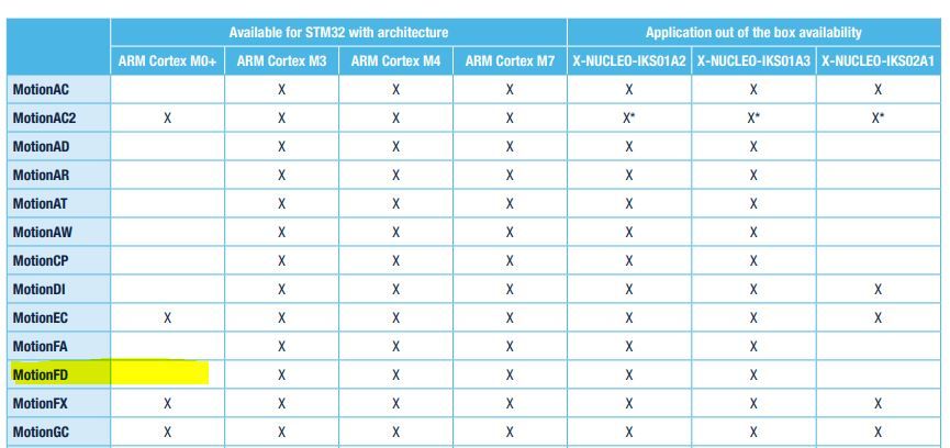

Does STM32L083RZT6 support motionFD library?

Imen.D
Hello @jason239955_st​ ,
The motionFD is not supported for STM32L0.
So far MotionFD library is not provided for Cortex-M0.
