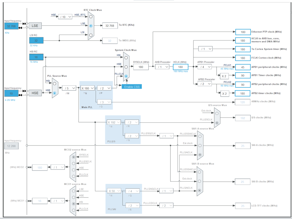

Something is wrong with the clocking and i cant figure out. When i try to debug with step over,
 the error handler in void SystemClock_Config(void)
  Error_Handler();
Takes me to
   /* Wait till LSE is ready */
   while(__HAL_RCC_GET_FLAG(RCC_FLAG_LSERDY) == RESET)
    if((HAL_GetTick() - tickstart ) > RCC_LSE_TIMEOUT_VALUE)
     return HAL_TIMEOUT;
in hal_rcc.c. where i am forever stuck.

waclawek.jan
Which STM32?
What is the hardware? Is this a "known good" board such as Nucleo or Disco, or your own?
Discovery F429i
waclawek.jan
The LSE crystal is probably not populated by default, including its surrounding circuitry (capacitors, jumpers). Read OSC 32 kHz clock supply chapter in UM1670.
