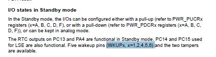

Referring to RM0444 and DS12232 (referring to STM32G0x1 programming manual and data sheet).
In the Low Power section, the RM states that there are five wakeup pins:
0693W00000Nt4V0QAJ.jpgBut in the register section, there is clear mention of WKUP3 (EWUP3 bit in PWR->CR3, WP3 bit in PWR->CR4, WUF3 bit in PWR->SR1, and CWUF3 bit in PWR->SCR).
However, when I look at the CMSIS files (stm32g081xx.h), I see:
#define PWR_SCR_CWUF_Msk          (0x3BUL << PWR_SCR_CWUF_Pos)
0x3B = 00111011 --> note, the third bit (CWUF3) is not included in the mask.
Are the register maps in RM0444 wrong for including bits for WKUP3, or is there some hidden use for WKUP3 I haven't found yet?
Edit: also, WKUP3 does not appear anywhere in DS12232 (Data Sheet for the STM32G071)

Hi @SHobb.1​ ,
I confirm this issue.
The STM32G031, STM32G041, STM32G051, STM32G061, STM32G071 and STM32G081 have five wakeup pins (WKUPx, x=1,2,4,5,6).
The STM32G0B1 and STM32G0C1 have six wakeup pins (WKUPx, x=1,2,3,4,5,6).
I reported this issue internally.
Internal ticket number: 131448 (This is an internal tracking number and is not accessible or usable by customers).
Kaouthar
