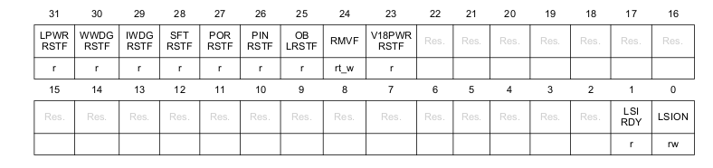

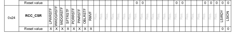

Documentation Issue in RM0360 and RM0091 RCC register map is not showing the V18PWRRSTF bit.
2022-12-28 7:32 AM
Here is the RCC_CSR definition in RM0091 and the register map entry for for the same register.
Unfortunately the register definitions do not match.

Hello @Everclear and welcome to the Community :),
Thank you for bringing this issue to our attention.
I confirm the issue and the V18PWRRSTF bit must be added in the register map section in the reference manual.
I reported this issue internally.
Internal ticket number: 145294 (This is an internal tracking number and is not accessible or usable by customers).
