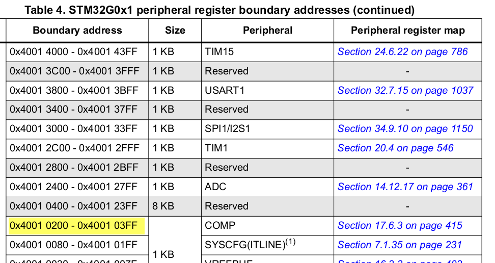

Offset values shown in Table 84 are out of range according to Table 1.

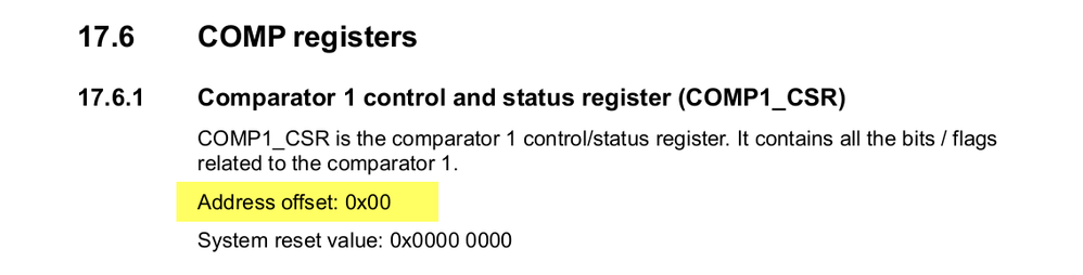

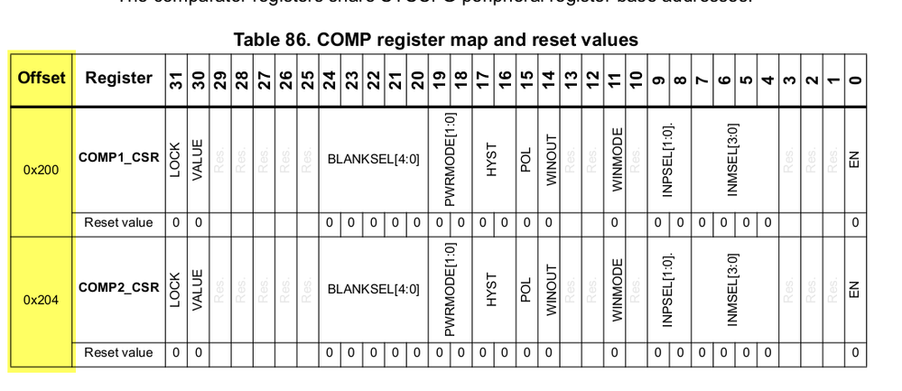

Also, "Address offset" of each COMP registers is different from the table.

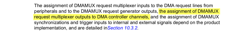

Section 10.1 says that the assignment of DMAMUX request multiplexer outputs to DMA controller channels is detailed in Section 10.3.2, but it isn't.

‎2021-03-22 7:45 PM
I think register table is now fixed in Rev 5.
I still see DMAMUX documentation is unclear about how "dmamux_req_outx" are assigned to "dma_req[x]".
