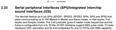

‎2025-01-16 2:31 PM
This says 4-16 bit frames. Are bigger frames available in software?

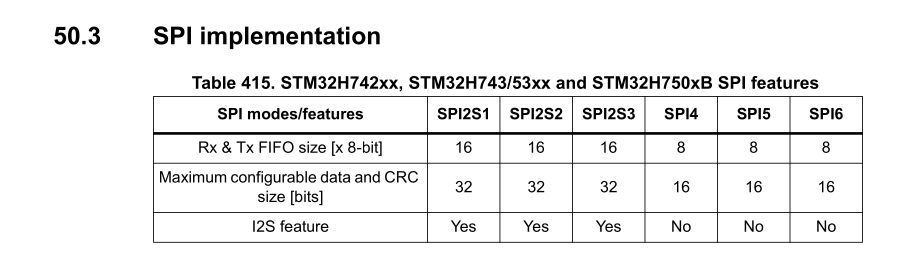

‎2025-01-16 11:54 PM
Not every SPI can use 20b format...see rm :
‎2025-01-17 12:41 AM
If an MCU supports 10-bit frames, 20-bit data may be sent/received as 2 10-bit frames.
‎2025-01-17 10:04 AM
Whoa, what document is that from?
