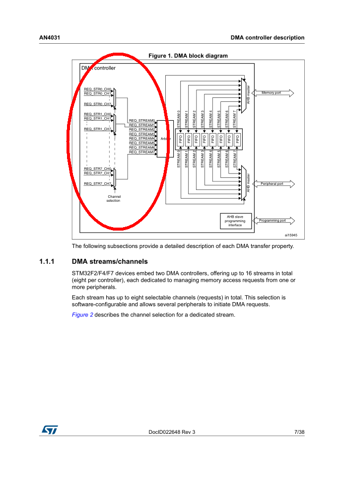

Suppose I would like to transfer a memory buffer content to SPIx TX.
When do each transfer occurs ? Every time I change the content of the memory buffer ? Always ?

waclawek.jan
Each time there is a request .
0690X00000ApLY1QAN.pngJW
Oh, what a fool.
I understand that this is a matter of enabling / disabling the stream.
Thanks.
