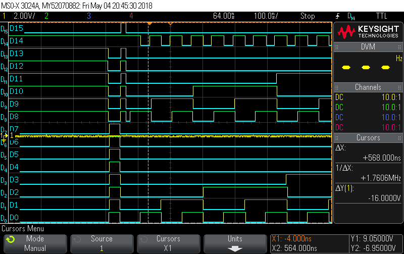

I found a hack that works.  In the timer interrupt which fires the DMA I first send 2 bytes out the FMC with the CPU.  This does not show up on the FMC bus, but when the DMA fires, all 128 bytes appear.  There is an address/data glitch before the DMA starts writing, but this has no write strobe so it is a don't care state.
for(i=0; i<2; i++) ptr[0] = image_buf[offset];   // dummy transmit
DMA2_Stream0->CR |= 1;   // turn on DMA engine
Just sending 1 byte does not work.  Sending more than 2 expands the time between the bus glitch and the first byte coming out the DMA.

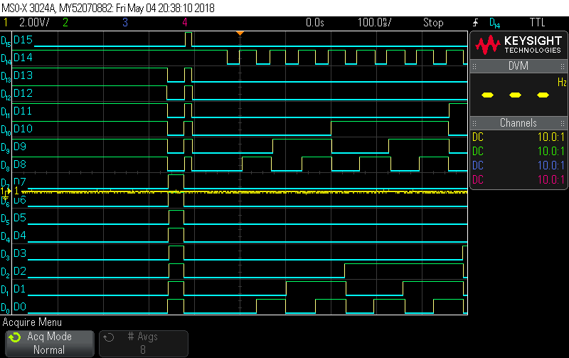

So here is what I first got with just DMA from internal RAM to FMC bus:

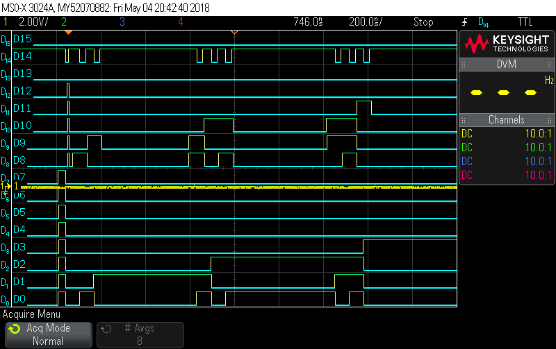

D0-D7 is data, I count from 0 to FF but split into two 128 byte blocks.  D8-D13 is lower address, D14 is NWE and D15 is a GPIO signal for the FPGA.   The ''glitch'' is on D8-D13 and D15 at the start of transfer.  To see what was happening I removed the DMA and just used the CPU to write to the FMC.  That resulted in this:
Cache is disabled for both instruction and data.  Note that D15 does not glitch, but the other lines do.  That might rule out cross talk (an analog problem) but maybe not.  The first byte of 0 is still missing.  So I then wrote 2 bytes using the CPU before firing the DMA and got it to work:
The glitch is still there, but the first DMA write is data byte 0 on address 0.  The FPGA will use the address on falling edge of NWE and the data on rising edge, so this is perfect.  My GPIO signal for the command is much wider so I can ignore the glitch on D15.

I'd like to ask details on the 2nd picture ('manual write' - it's IMO better separate what appears to be a FMC problem from ). How exactly did you write? Are the bursts of 3 writes intended? What is before the first write - isn't there any write? Can you show code? Can you please read out the content of FMC and relevant GPIO registers and post it?
Also, did you use the analog function to observe the glitch, on whatever line (but certainly on the write(D15))? Can't this be some grounding issue? Can't there be some short which generates a glitch on the supply of the particular port? Can't there be some momentary conflict on the buses from the FPGA side (i.e. can't both the MCU and FPGA attempt to output data to the bus at the same time)?
