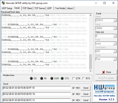

Hi, is clear that uart pins are connected , the counter of received bytes is a real value. I try this one:
1. Stop RTOEN interrupt
2. And get interrupt from DMA when buffer is HALF and FULL :
and I have data in DMA buffer:
  huart2.Instance->RTOR = 100;
 // __HAL_UART_ENABLE_IT(&huart2, UART_IT_RTO);
 // huart2.Instance->CR2 |= USART_CR2_RTOEN;
  HAL_NVIC_SetPriority(USART2_IRQn, 0, 0);
  HAL_NVIC_EnableIRQ(USART2_IRQn);
 this is in : static void MX_USART2_UART_Init(void)

this is on DMA interrupt. Then we have data:
So DMA work , but if i set RTOEN the buffer stops filling.
My MCU is STM32H743VIH6. Uart2 (DMA)  pins are PA3 , PD5
If you can check on some dev. pcb code with this MCU or similar. May be have some problem with memory mapping ? I don't know. DMA received counter work , but nothing in buffer when RTOEN is active. Can you build a project for this MCU to check it here ?
Brussl
Hello Gyessine, I find problem , but don't know why this is problem at all. When i enable ICache and DCache ,DMA stop writing in buffer. Seems like not access or addressing is missing to buffer in RAM.
Now all work but where is real problem I don't understand.
