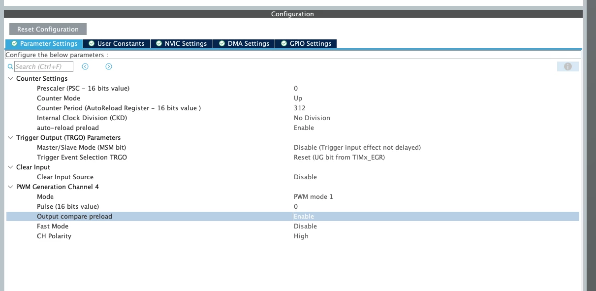

  • PWM base frequency: ~770 kHz (period ≈ 1.3 µs).
  • ARR: 312‑1 (312 ticks → 240 MHz/312 ≈ 769.23 kHz).

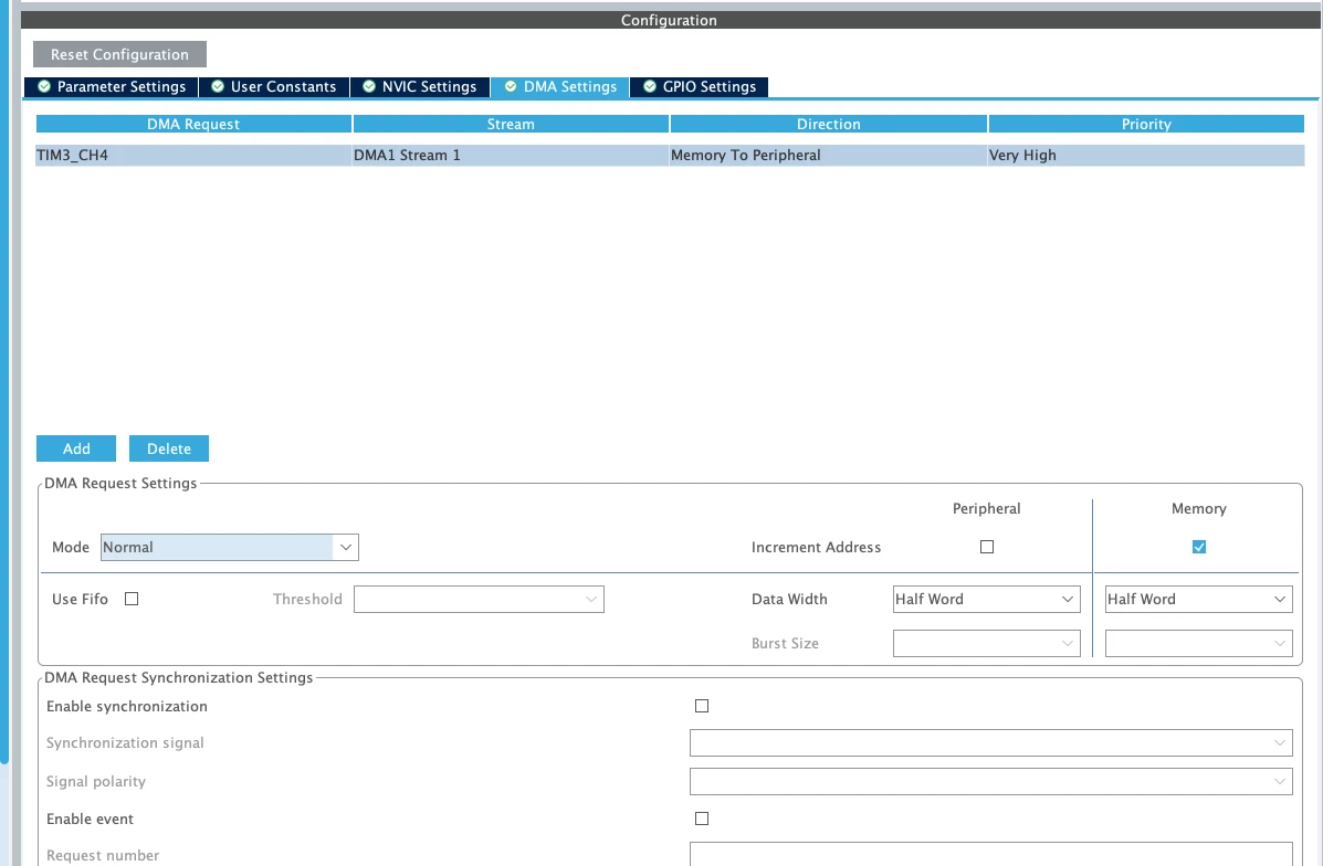

  • DMA: Peripheral = TIM3_CCR4, Memory in RAM_D2, half‑word alignment (16‑bit duty), MemInc enabled, PeriphInc disabled, Mode = Normal.

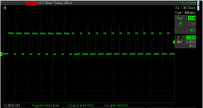

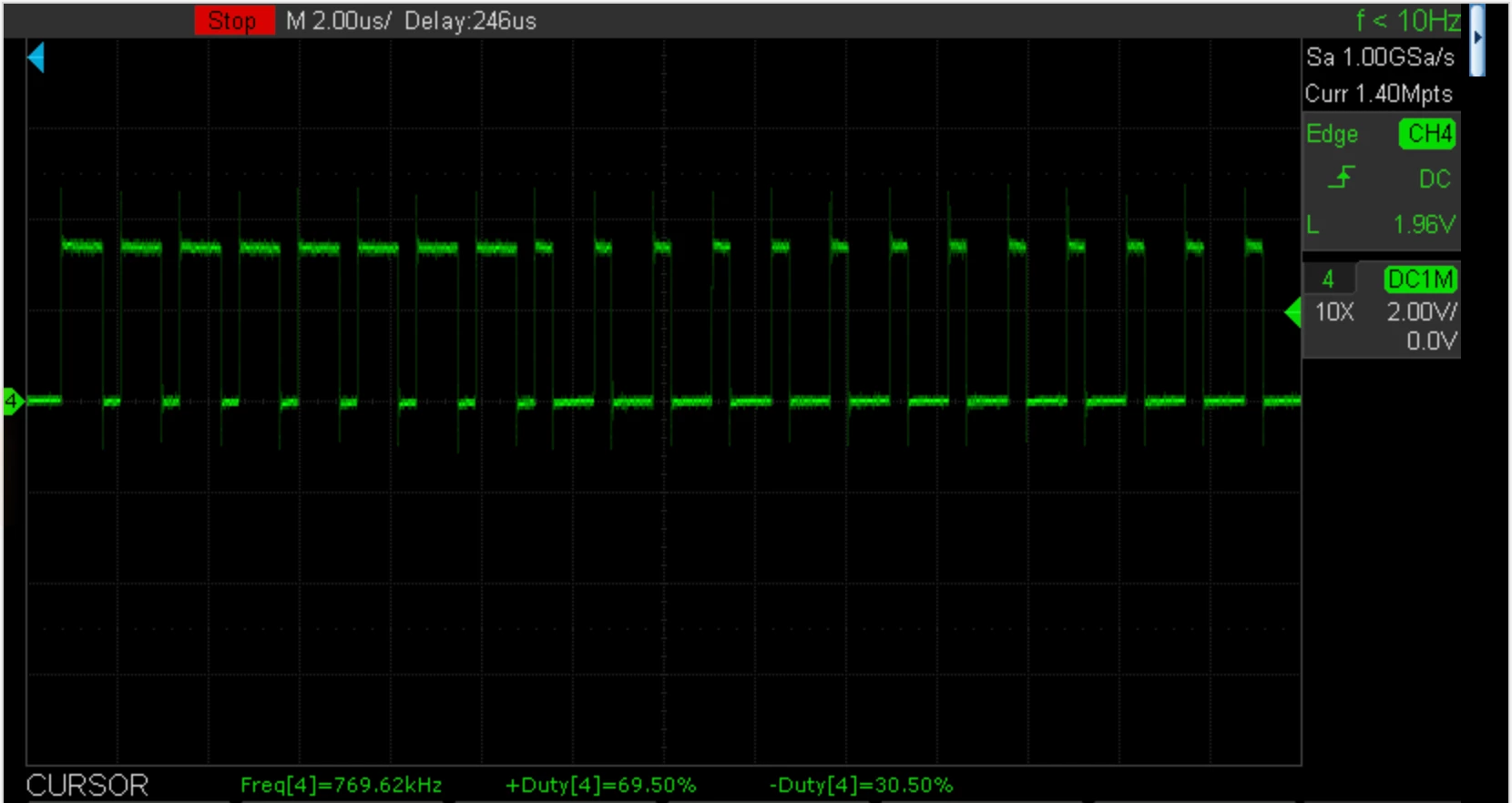

When I enable PWM + DMA, the waveform becomes random/discontinuous. On the oscilloscope I see “splits” and gaps; the PWM is not continuous. For example, the first 8 bits might be high and the following 16 low (intended to represent RED), but the stream breaks unpredictably. The data buffer looks correct when inspected in the debugger.

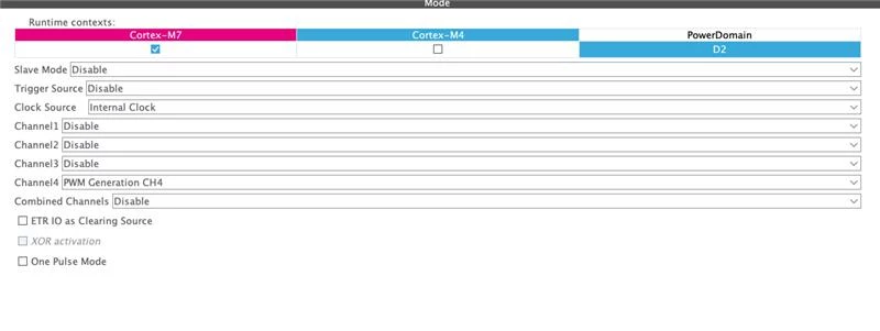

I am using channel 4 timer 3. with internal clock source.
and DMA is configured as:
where data width is half word since the pulse of the PWM generator channel 4 is 16 bit value.

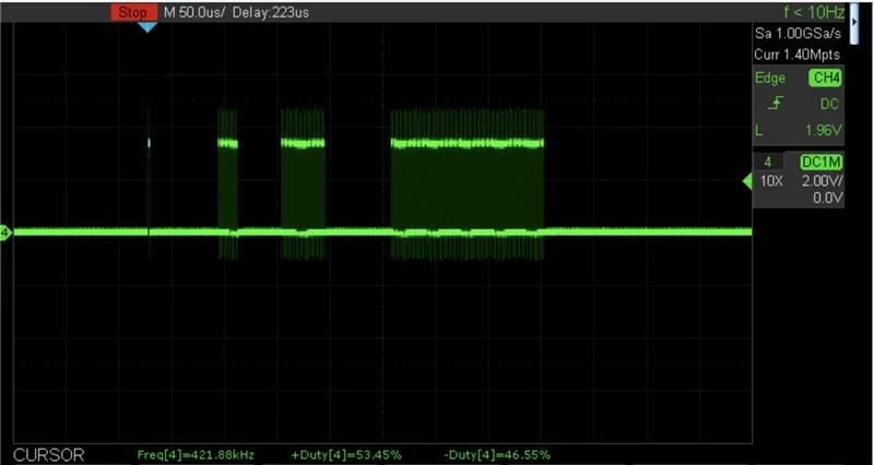

Everything is normal to me, but this is what my oscilloscope gets:
with zoom (the first 8 bits are high, and the 16 folowing are low, meaning red colour (RGB)):
My problem is that the PWM is random, and never correct.

Change in configuration in DMA for Memory from HalfWord to Byte. Do not change for Peripheral. Also change buffer pwmData and ALLRED from uint16_t to uint8_t.
Best Regards.
February 5, 2026
Yeah,
i tried so, however i do not why (maybe is a bug) both memory an peripheral must have the same length. I mean, the GUI forces the memory size to be equal to peripheral…
Visitor II
February 5, 2026
Change in the generated code, not in GUI. Only for test.

1. Why don't you use UART or SPI - much less data required.
2. I don't use HAL, so I am not an expert there but I believe the size argument for HAT_PWM_Start_DMA should be the number of items rather than size in bytes.
3. When using PWM, make sure to add one more element to the table with a value of 0, so that timer output stays at 0 between packets.
4. Make sure that pwmData is a static object, not a function's local variable.
