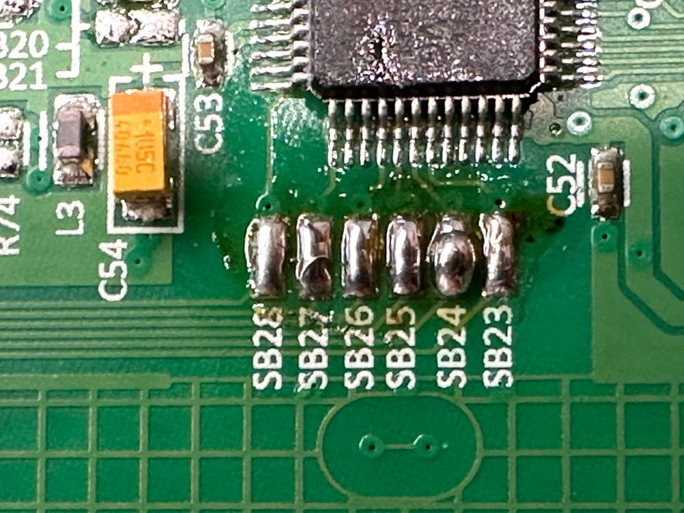

Using a Discovery L0538, and want to make use of the 2nd UART (really only need the RX on pin PA3). I noted in the User Manual that to disable the onboard touch sensor and use this pin, I need to jump solder bridge SB24 (which I did, alng with the other five SBs next to it).
However, this pin appears stuck low when I try to receive data on it (all zeroes). I am using a RS232 to TTL converter board to send data to it. If I remove the wire from the converter to PA3, I can see the correct data from the converter board. But as soon as a solder it back to PA3 all I get is zeroes. I config'd the UART with MXCube; note that UART1 is working fine.
Have I missed something else to get this pin working as a UART? I verified with a DMM the solder bridges have continuity. Not detecting a short to ground on PA3. Tried enabling the pullup on that pin, no change.

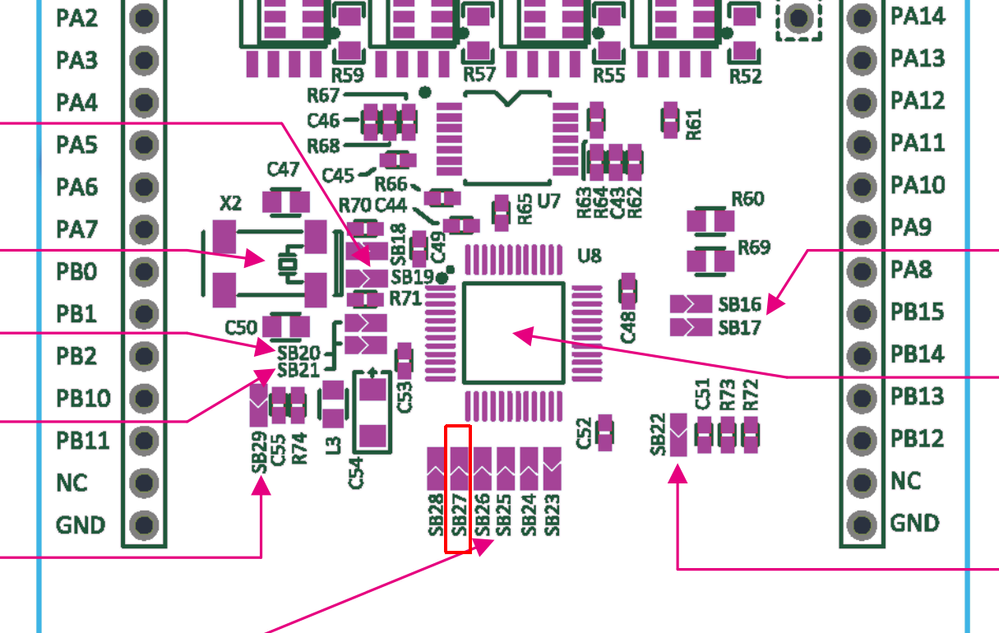

I just checked, and PA3 is connected to SB27, not SB24.
Are you sure you did not accidentally connected neighbouring pads on the row of solder bridges, i.e. shorted SB27 with SB26 or SB28?
Good catch; the chart on page 25 of the User Manual sure seemed to suggest to me that PA3 corresponded to SB24. Either way, I just checked: I have good continuity across SB27, and no continuity between SB27 and SB26 or SB27 and SB28.
