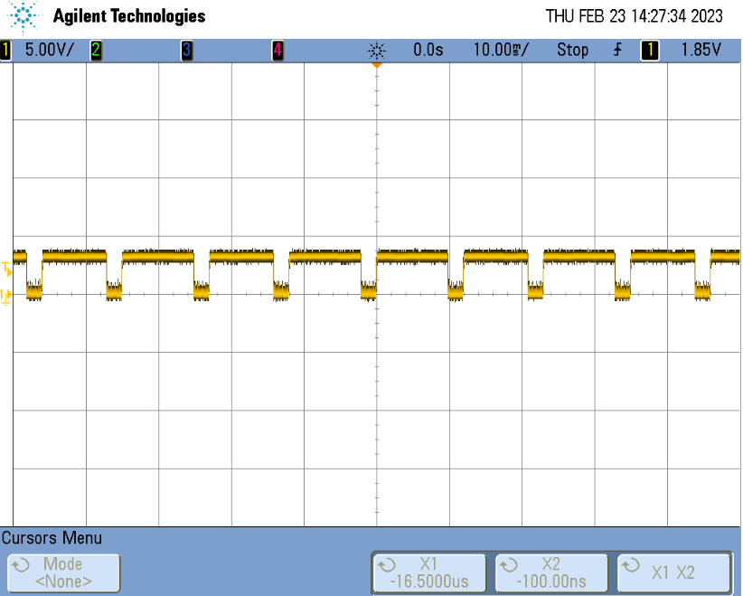

However, this pin appears stuck low when I try to receive data on it (all zeroes). I am using a RS232 to TTL converter board to send data to it. If I remove the wire from the converter to PA3, I can see the correct data from the converter board. But as soon as a solder it back to PA3 all I get is zeroes. I config'd the UART with MXCube; note that UART1 is working fine.
Have I missed something else to get this pin working as a UART? I verified with a DMM the solder bridges have continuity. Not detecting a short to ground on PA3. Tried enabling the pullup on that pin, no change.

From schematics it appears that PA3 has a fixed connection to C14/47nF. This is not ideal, but shouldn't cause the symptom you describe.
Try to write a simple code which sets PA3 as GPIO input, a suitable pin as GPIO output, and do nothing just move in a loop level of PA3 to that output pin, and then check using oscilloscope.
If this works, your setup is wrong, it does not matter that you've clicked it in CubeMX. Read out and check/post content of USART and relevant GPIO registers.
nobbyv77
I am absolutely stumped. I created a new project w/ no UART, just the one active GPIO in question (PA3) that I toggle. Works fine, so no shorts on the pin. Started a new project w/ nothing else besides the two UARTS, both init'd as per CubeMX. Swapped the output of the RS232/TTL converter between UART1 and UART2. UART1 works perfectly fine. UART2 only captures zereos. The init code is IDENTICAL. What could I possibly be missing?

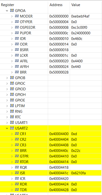

waclawek.jan
In debugger, read out USART registers and GPIOA registers, and post what you read out.
jvavra
This is the contents of the GPIOA and UART2 registers when I am receiving all zeroes on UART2. I set a breakpoint in the HAL_UART_Receive_IT routine just before the function returns.
