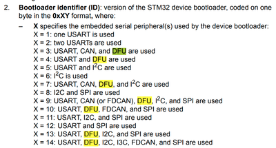

Should function the same. There are a lot of "different" system bootloaders to support all the various chips.
