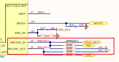

PetrK

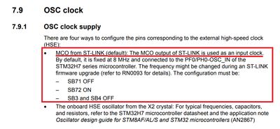

I goes through the user manual once again and realize that the inputed HSE frequency is provided by ST LINK MCO - 8 Mhz. There was set authomaticly 25 Mhz in the clock configuration.
https://www.st.com/resource/en/user_manual/um2408-stm32h7-nucleo144-boards-mb1363-stmicroelectronics.pdf
7.9.1
I followed tutorial paths for set HSE, but nobody mentioned, that it is necessary to improve the solder bridges on the board to connect the external oscillator. This is my first STM32 board, so I do not know if it is standard or something special for my H7 version.

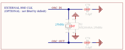

Indeed by default the HSE clock source is generated by the STLINK MCO:
From the board schematics, SB72 is soldered by default:
And the HSE crystal is not available (DNF: Do Not Fit):

" I followed tutorial paths for set HSE, but nobody mentioned, that it is necessary to improve the solder bridges on the board to connect the external oscillator. This is my first STM32 board, so I do not know if it is standard or something special for my H7 version. "
What kind of tutorial ?
Nucleo working as it is, AFAIK ST-Link always provides clock on any nucleo boards, with option 8 or 8.33 MHz.
No hardware re-config required. Simply enter 8 MHz into box instead of 25.  Likely software StmCubeMX bug or you start project in another way - from uCPU selector instead of board selector.
