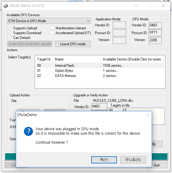

Hi.
I am testing with the ST Discovery Lora Kit, B-L072Z-LRWAN1.
Dfuse Demo (v3.05) does not download firmware properly.
The error message is shown below.

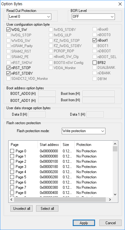

The following image is the contents of the option byte.
There is no revision.

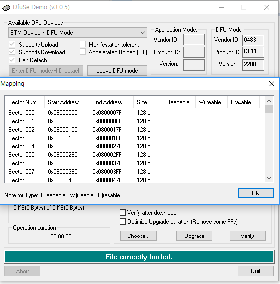

A similar error has been found in the STM32L0 series.
Is there a problem with the STM32L0 series?
Please give me the solution to the above.

Posted on June 19, 2017 at 01:53
Well the error you've provided just indicates you have a generic STM32 L0, which can't be differentiated from millions of others, or thousands of other customers products using an L0, and not with some unique VID/PID to you as a customer.
