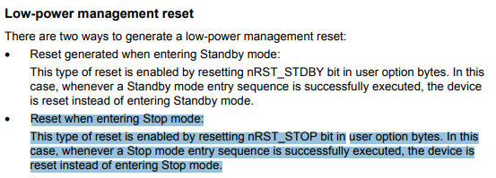

I would like to use the nucleo-stm32l031 to some low power tests.
I'll try the NUCLEO-L011K4->PWR_STOP_RTC and also the NUCLEO-L031K6->PWR_STOP_RTC. Both example don't work on my NUCLEO-L031K board.
The problem is that the MCU don't go in STOP mode. The application should pu the MCU in stop mode for 10 or 20 seconds.
But the green led is always on since the board never go to stop.
I put here the code from the example as reference.

Is it possible to use the NUCLO board to test this ?
Does something else I need to do to put the MCU in stop mode ?
I have try the NUCLEO-L476 and it's work as expected on a nucleo-l476 board.
2 REPLIES 2
jdumaresq
Just to add that if I use HAL_PWR_EnterSLEEPMode instead of HAL_PWR_EnterSTOPMode
The code work as expected.
From my debugging, the board reset when calling the HAL_PWR_EnterSTOPMode
jdumaresq
Just found the answer....
