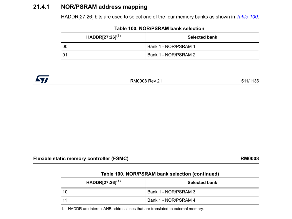

I wish to know the external memory address(0x60000000 - 0x7fffffff) partitions. And I wish to learn more about memory mapping. So, if there anyone find the detailed document about memory mapping, please share it with me.
waclawek.jan
Which STM32?
For example, for 'F1, Bank1 (i.e. SRAM etc.) :
0693W00000Y7jXFQAZ.pngIt means that the individual chipselect pins allow to address 0x6000'0000-0x63FF'FFFF,0x6400'0000-0x67FF'FFFF, 0x6800'0000-0x6BFF'FFFF, 0x6C00'0000-0x6FFF'FFFF areas, respectively.
0x7000'0000-0x7FFF'FFFF is Bank2, i.e. NAND FLASH area.
This is probably the same for all other families, but telling us your STM32 model up front is always a good idea.

SivM
In reference manual they don't give detail about external memory device region. That's why i need some detailed document about memory map region of external device.
I need to know is there any partition in between external memory address region of 0x6000000 to 0x7fffffff

SivM
Thank you so much Mr.waclawek.jan. My doubt was cleared now.
