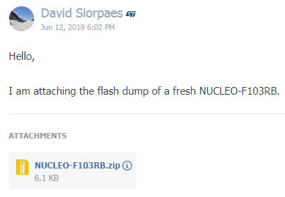

Posted on June 12, 2018 at 18:02
I am attaching the flash dump of a fresh NUCLEO-F103RB.
________________
Attachments :
NUCLEO-F103RB.zip : https://st--c.eu10.content.force.com/sfc/dist/version/download/?oid=00Db0000000YtG6&ids=0680X000006HxVc&d=%2Fa%2F0X0000000az4%2FSeyIL01GtcMYF5L28JZTKXxDNZIpMg5FdPrwDj.AJ8g&asPdf=false

Posted on June 13, 2018 at 10:57
Hi Uwe,
hmm... should appear just below the message:
This is the direct link:
https://community.st.com/servlet/JiveServlet/download/201675-1-12552/NUCLEO-F103RB.zip
(also re-attaching it here).
