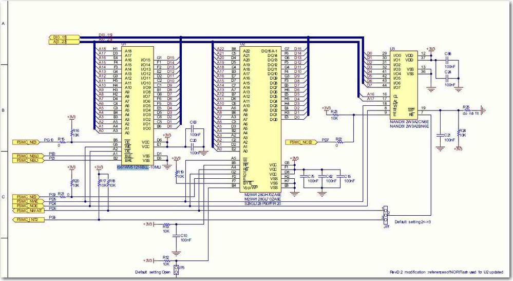

can I use this :
http://www.digikey.com/product-detail/en/IS62WV102416BLL-25TLI/IS62WV102416BLL-25TLI-ND/1831392 with STM32F103VCT6 ? do you have any examples schematic on interfacing 8 Mbytes SRAM to STM32 ? thanks- Mark as New
‎2014-04-22 6:43 PM
Look at the STM3210E-EVAL, and add more high-order address bits.
‎2014-04-22 7:51 PM
this one ?
‎2014-04-22 8:27 PM
what's the different between 512 x 16 and 1024 x 8, does it matter or the different is per word only ? can I use STM32 with x8 ?
The 16-bit wide ones would give you better bandwidth, I suggested a schematic based on the part you specified, for the 8-bit you'll have to source your own. I believe it should support 8-bit parts, review the documentation.Up vote any posts that you find helpful, it shows what's working..
