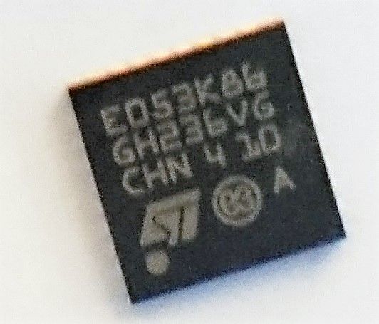

Posted on November 15, 2016 at 08:30
Please find the attached pictures of the device STM32L053K8U60690X00000603D3QAI.jpg
waclawek.jan
Posted on November 15, 2016 at 09:58
That's it - the E053 marking instead of L053 tells that these are engineering samples.
Thanks for the picture.
krish
Posted on November 16, 2016 at 03:13
Hi Jan,  I was just wondering, as these are Engineering Samples, why is Arrow.com selling them in the first place and that too with wrong information on their webpage?
