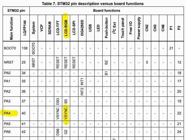

As TDK pointed out, probably PA4 is connected to LCD screen VSYNC:
2021-12-21 7:04 PM

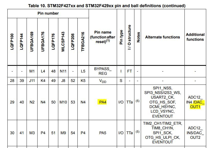

Hi, the datasheet PA4 pin is DAC_OUT1.
2021-12-21 7:14 PM
It is DAC_OUT1. However, it's already connected to something on that board (VSYNC) which is driving that pin. When two things drive a pin, only one of them can win. In this case, looks like VSYNC is winning.
2021-12-21 7:46 PM
