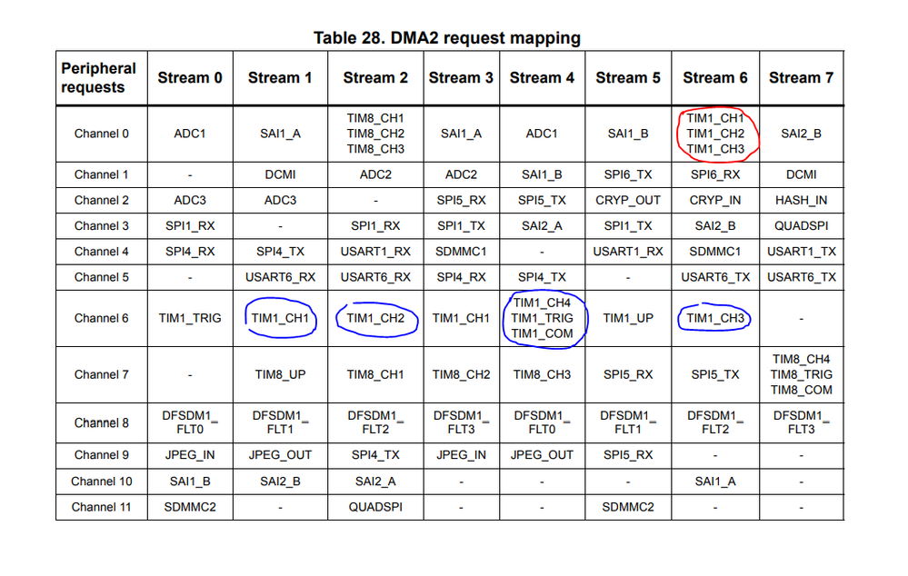

Hi all,
I have a STM32F765, which i want to use to generate 4 D-shot signals on 4 GPIO, in the specific 4 gpio connected to Timer 1 .
The timer is set as 4 channel pwm with DMA (memory to perpheral).
The issue is that i'm able to generate the desired signal only for 2 channels (CH1-CH4).
The CH2 and CH3 do not produce any output.
I'm quite sure the issue depends on the DMA.
Without DMA i can generate a PWM / Pulse on all the channels.
In addition if the each timer's channel has its dedicated dma, then all works fine.
Note that in the main loop a generic buffer of 5 entries is streamed on the dma (a Dshot has a dimension of 26)
So the issue is related to DMA2 stream 6 / Channel 0, where 3 timer channels are processed together:
0693W00000AMvOnQAL.png Solution:
Each timer channel needs a dedicated dma stream

For example stream 1 channel 6 means that compare/capture event on TIM1_CH1 generate DMA request and DMA moves single data element from source to destination (for example from memory to TIM CCR1).
In case Stream6 Channel0 you should enable only one of three DMA request (CH1 or CH2 or CH3) in timer. If you enable all three request, they will be logicaly ored (if i remember correctly) and that means any event (on CH1,CH2 or CH3) generate DMA request - your DMA move three data elements into single register in timer (!). You need use 4 DMA streams (1,2,4,6). Or if you want use only one DMA stream you have to use DMA Burst mode (timer feature).

The issue has been temporary solved using different dma streams for each timer channel!
Not sure how it would write 4 sets of registers otherwise. Burst mode at Update?
Your code doesn't seem to be using or attempting to use that.
And yes, you can't share DMA resources between TIM, and the mapping limits the options.
HAL_TIM_DMABurst_WriteStart ?
Does it mean that with dma2 stream 6 channel 0, it is possible to use only one channel between CH1,CH2,CH3?

This answer my question. Thanks.
I used dma2 stream 1,2,4,6!
The problem was mostly related to a not deep understanding of the dma. About the D-Shot, it doesn’t really matter. I will change the title of the thread with generic buffer, instead of d-shot!
