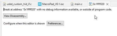

Also, when i create the programm, i have this kind of error
do you know what could be the source ?
Steeve_Osteen
Hi all, for the last error, seems an issue with BOOT0 but do not seem to have any issue with the programm.
But, it do not solve my issue with the USB connexion which do not seem to be recognised by the PC.
